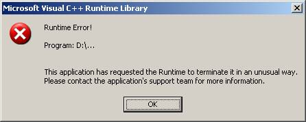

When I run BestSync, the following "Microsoft Visual c++ runtime library runtime error" dialog box popup, what can I do?
If the problem still exists, please install the following redistributables also:
32Bit Version: Microsoft Visual C++ 2008 SP1 Redistributable Package (x86)
64Bit Version: Microsoft Visual C++ 2008 SP1 Redistributable Package (x64)
