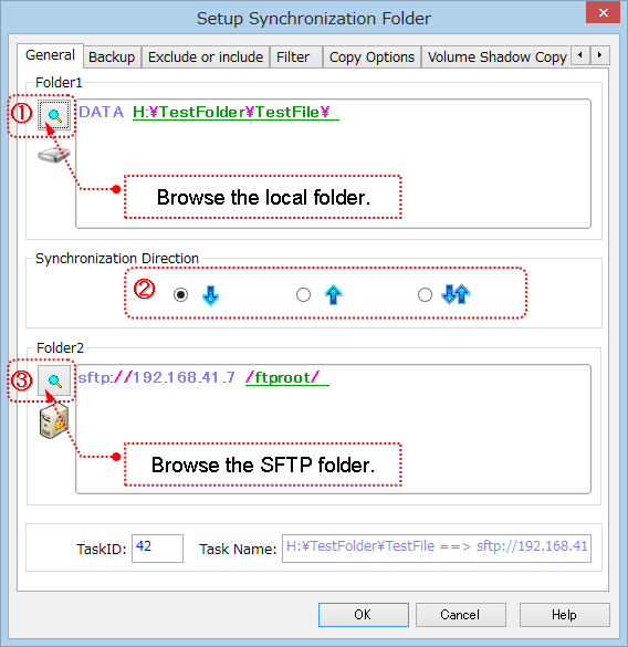

How to setup a task to synchronize with SFTP server folder.
Setup Task to sync SFTP
1. Click explorer to select the local folder into the "Folder1" edit box.
2. Select the synchronization direction.
: One-way synchronize from Folder1 to Folder2.
: One-way synchronize from Folder2 to Folder1.
Two-way synchronization.
3. Click explorer to select the SFTP folder into the "Folder2" edit box.
(1). Select "SFTP - SSH File Transfer Protocol" in the "File System" list.
(2). Setup the parameters for connecting to the SFTP server.

(3). After set up the SFTP host name and account, press "Go" button to connect to the SFTP server, and list the folders in the SFTP server to the tree view.
The log window below the treeview logs all the commands sent to the SFTP server, and responses from the SFTP server. If the connection between BestSync and SFTP server can not be established successfully, please check the log.
(4). Select the folder in the tree view.
(5). Click "OK" button to end the dialog box
4. Press "Next" to set other options, or press "Finish" to end the task wizard.
