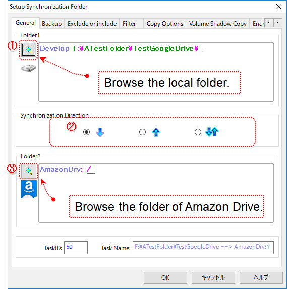

1. Click
to select the local folder into the "Folder1" edit box.
2. Select the synchronisation direction.
: One-way synchronise from Folder1 to Folder2.
: One-way synchronise from Folder2 to Folder1.
Two-way synchronisation.

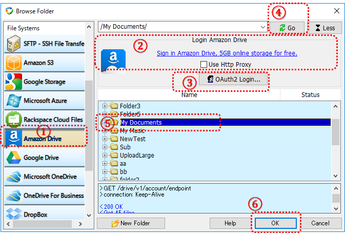

3. Click
to show the "Browse Folder" dialogbox to select the folder of Amazon Drive into the "Folder2" edit box.
(1). Select "Amazon Drive" in the "File Systems" list.
If you have not got an account, you can click "Sign in Amazon Drive, 5GB online storage for free" link to apply a Amazon Account.
(2). Click "OAuth2 Login" button.
BestSync opens the web browser for you to login Amazon Drive, please input the Amazon account (an email address) and password to allow BestSync to access your Amazon Drive.
Use http Proxy:
If the local computer is behind a firewall or NAT, usually the computer needs the proxy to connect to the Amazon Drive server.
If this option is checked at the first time, the "http Proxy" dialog box will be popped up for setup up the http proxy server.
(3). After set up the parameters above, press "OAuth2 Login" button.
The "OAuth2 Login" dialogbox pops up, input Amazon Account and password to login Amazon Drive, allow BestSync to access your Amazon Drive.
If login Amazon Drive successfully, Access granted,please press "Close" button to end the dialogbox. is displayed in the dialogbox.
Press "Close" button to close the dialogbox.
(4). Press "Go" button to refresh the file tree.
BestSync lists all the folders in Amazon Drive, and display the folders in the file tree.
The log window below the file tree logs all the commands sent to the Amazon Drive, and responses from the Amazon Drive.
If the connection between BestSync and Amazon Drive can not be established successfully, please check the log.
(5). Select the folder in the file tree for synchronisation.
(6). Click "OK"button to end the dialog box.
