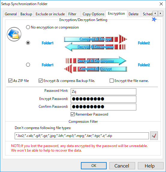

4. In the "Encryption" tab, set the encryption settings.
(1). Select the encryption option according to the synchronisation direction.
Usually you need to encrypt files on the DropBox, if the DropBox folder is "Folder2", select the arrow "Compress & Encrypt" radio-box.
If "AS Zip File" is checked, the file will be encrypted by AES256 as an individual standard .zip file. This option is useful for synchronising and encrypting the file to cloud storage such as Google Drive, then view it from smartphone.
If "AS Zip File" is not checked, the file will be encrypted by AES256 by the original format of BestSync. You need to use BestSync decryption tool to decrypt the file.
If you also need to encrypt the file names, you can check "Encrypt the file name".
(2). Set the password and the password hint.
The password hint is the text for you to remember the password.
Because BestSync compresses files before encrypting them, to prevent compressed files being compressed again, you can specify the file types such as *.zip, *.jpg etc files in the "Don't compress following file types" editbox.
