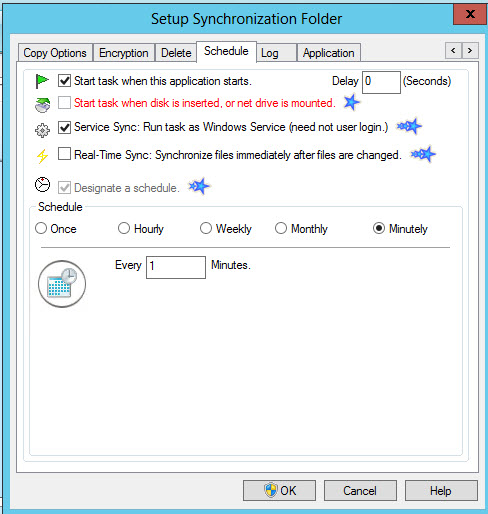

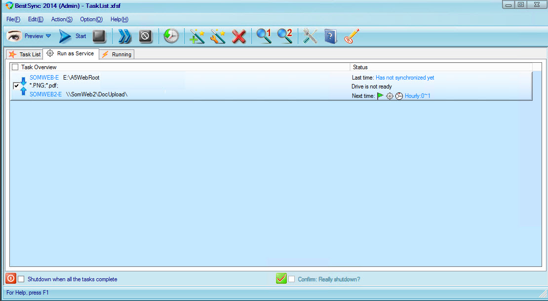

Trying to sync from local folder to a another folder which is in a different computer(Remote). In the Schedule I selected the Minutely option. It is also selected to Run task as Windows Service. It is NOT working ... It will work if I click the Start from the menu option.
I really need to make sure the file is copied when it is created. Please see attached images.

Drive is not ready
Drive is not ready

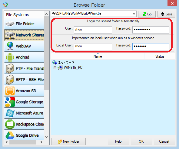

Please check if the task has setup the logon account for the network drive and the service like the following screenshot:
[attachment=0]SyncNetSvc.png[/attachment]
Or check the following page to resolve the problem:
http://www.risefly.com/fseqna.htm#SyncNetDriveAsSvc

I used this link: http://www.risefly.com/fseqna.htm#SyncNetDriveAsSvc and that fixed the problem for now.
1. How do go to the File System as shown in the above image that you posted?
2. In the schedule I was choosing the Minutely option. But Its needed to run from 6:00AM to 7:00PM. How do I set this up to run every minute but in that time range as mentioned before?

To show the logon dialogbox, you can just click the browser button of the folder.
I'm sorry that the minutely schedule can not set the time range of a day.
