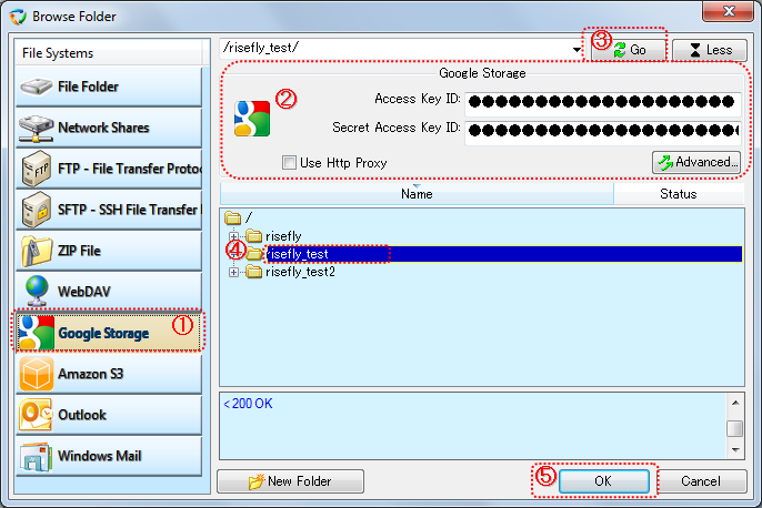

(1). Select "Google Storage" in the "File System" list.
(2). Setup the parameters for connecting to the Google Storage server.
Access Key ID: The Google Storage account, like "GOOGBRIXXXXXXXXXDOCM3"(about 20 characters).
Secret Access Key ID: like "87KNbpXxxxxxxxxxxxwxxxxxxxxxXXXXxxxBxuK" (about 40 characters).
Use http Proxy:
If the local computer is behind a firewall or NAT, usually the computer needs the proxy to connect to the Google Storage server.
If this option is checked at the first time, the "http Proxy" dialog box will be popped up for setup up the http proxy server.
(3). After set up the parameters above, press "Go" button to connect to the Google Storage server, and list the Buckets folders in the Google Storage server to the tree view.
The log window (below the treeview) logs all the commands sent to the Google Storage server, and responses from the Google Storage server. If the connection between BestSync and Google Storage server can not be established successfully, please check the log.
(4). Select the folder in the tree view.
(5). Click "OK"button to end the dialog box
