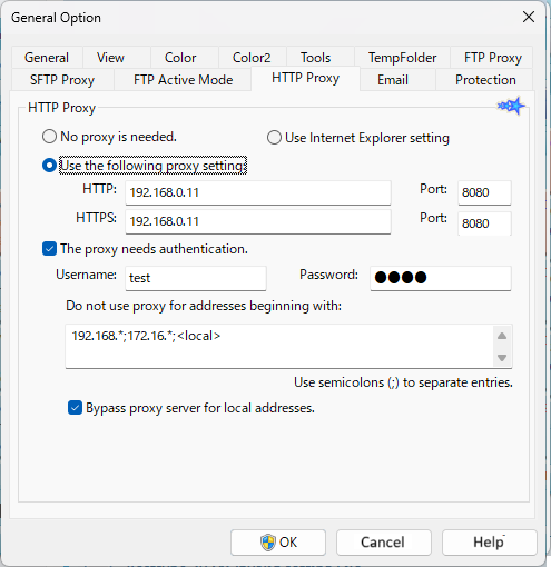

"HTP Proxy" Sheet:
Setup the HTTP Proxy sever.
Http Proxy
No Proxy is needed:
The computer connects to internet directly, no proxy server is needed.
Use Internet Explorer setting:
Use the "Connection" setting of Internet Explorer.
Note: BestSync saves the connection setting to its own registry, if you have changed the Internet Explorer setting, please open this setting dialog box and click this option again to let Bestsync import the setting again.
Use The following proxy setting:
Specify the proxy settings here.
HTTP, Port:
Specify the IP address or the hostname of the HTTP Proxy server, and HTTP Port number. The default port number is 80.
HTTPS, Port:
Specify the IP address or the hostname of the HTTPS Proxy server, and HTTPS Port number. The default port number is 443.
The proxy needs authentication:
If the proxy server needs to be authenticated, check this option, and specify the "Username" and "Password" here.
If the proxy needs to be authenticated, but you have not specify the account here, the connection will be failed with 407 error, you can confirm the error code in the Preview Window.
Do not use the proxy for addresses beginning with:
You can bypass the proxy server for some IP addresses by specify the prefix of IP addresses here. Use semicolons (;) to separate entries.
Like the following:
      192.168.*;172.16.*
Bypass proxy server for local addresses:
Check this option to bypass proxy server for local addresses. Local addresses are in the same IP segment as the PC that BestSync is running.
