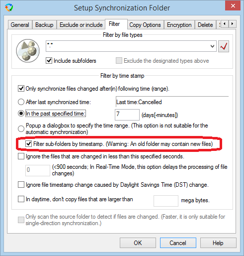

We have released version 9.0.5.6, the new version has added the following option to filter sub-folders by time stamp.
[attachment=0]filter_folder_tm.png[/attachment]
Please use this option carefully. If this option is selected, new files under an older folder will not be synchronized.
Filter Folder by time stamp
