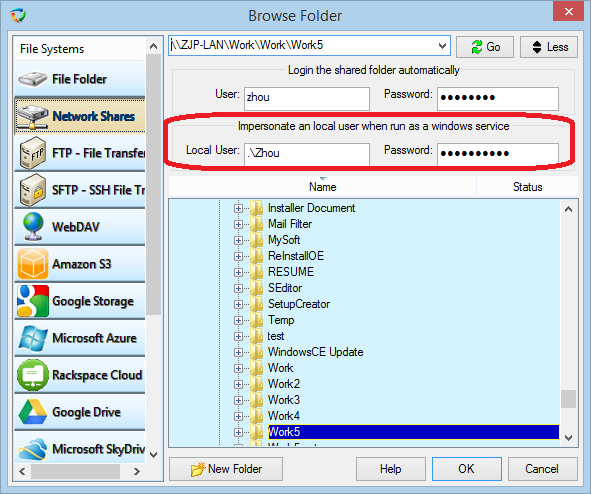

I am try to test Best Sync, and I keep getting a "Drive is not ready" message when I start the service task. - what does this message mean? How do I know if it is the source or the target drive?
Re: Drive is not ready
If the task is set to synchronize with a network shared folder and run as windows service.
Please download and install the new version 9.0.4.2, and setup a impersonate account like the screenshot:
[attachment=0]SvcLogon1.png[/attachment]
Service Logon
