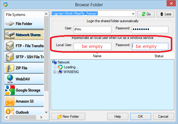

1. When browse the network folder, leave the settings of "Impersonate a local user when run as a windows service" be empty.
See the attached "no_impersonate.png" [attachment=1]no_impersonate.png[/attachment]

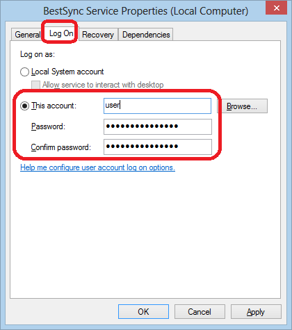

2. Setup a login account in "BestSync Service" of the service manager of the control panel
See the attached "service_logon.png" [attachment=0]service_logon.png[/attachment]
