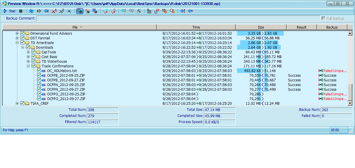

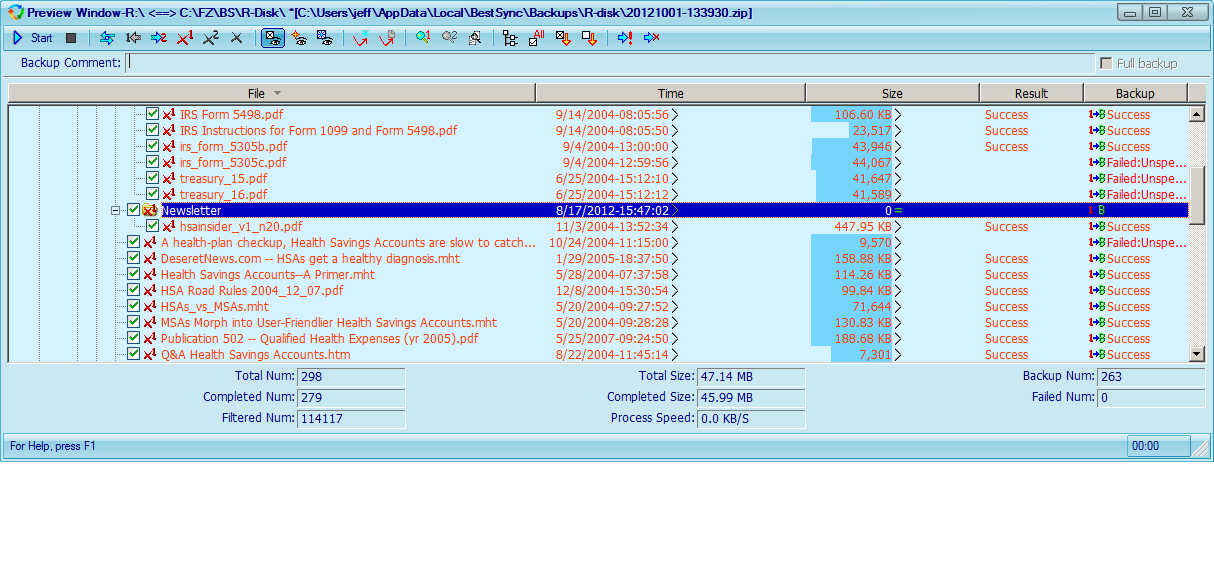

When BestSync becomes confused, here are the errors I'm seeing in the "Backup" column of BestSync's Preview window:
Failed: The system cannot find the path specified
Failed: Unspecified error
On one occasion, I also saw this error in the "Result" column of BestSync's Preview window:
Failed: The process cannot access the file because it is being used by another process.
The errors are intermittent and not perfectly repeatable. When I run the Preview and the executed the sync, some files synced and were backed up, but some files generated errors. If I immediately reran the preview and executed the sync, some of the remaining files were synced and backed up, but some of the remaining files generated errors. If I repeated the Preview and Sync enough times, eventually all the files were synced and backed up.

- Task where folder1 & folder2 are local.

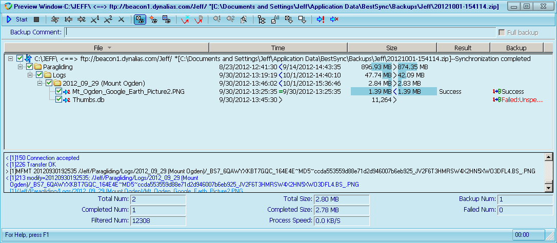

- Task where folder1 local & folder2 is FTP. First run of this task.
- Example_4a.png (42.29 KiB) Viewed 14676 times

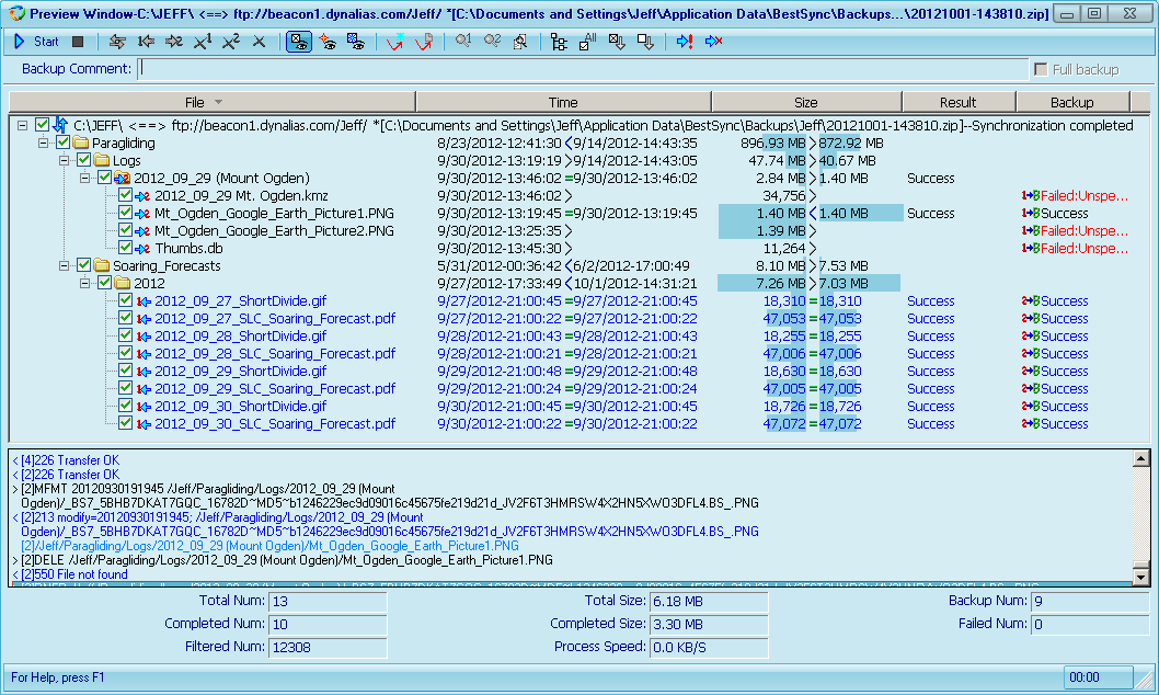

- Task where folder1 local & folder2 is FTP. Second run of this task.
- Example_4b.png (26.42 KiB) Viewed 14676 times

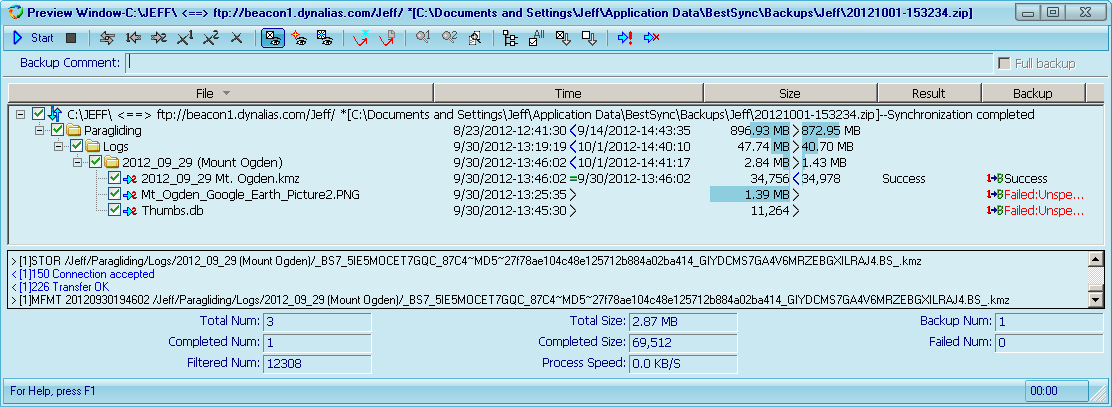

- Task where folder1 local & folder2 is FTP. Third run of this task.
- Example_4c.png (26.49 KiB) Viewed 14676 times
