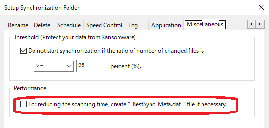

To stop BestSync scanning and remembering the last updated timestamp of an uploaded file, you can uncheck the option "For reducing the scanning time, create "_Bestsync_Meta.dat_" file if necessary. " in "Miscellaneous" Tab of the task setting.
Please try this method to see if it can resolve this problem.
- Uncheck use meta file
- Uncheck_use_meta.png (10.34 KiB) Viewed 124007 times

Thanks for your response. I have made the change as described. It looks like the files are being transferred now. The scanning time has been increased by ~8 sec though but it can be ignored for now. Please let me know if you happen to resolve this issue by some way in the upcoming releases. I will update to the new version.

Thank you for the response, and glad to hear the problem can be solved.
To uncheck the option is the best solution in BestSync for the problem.
