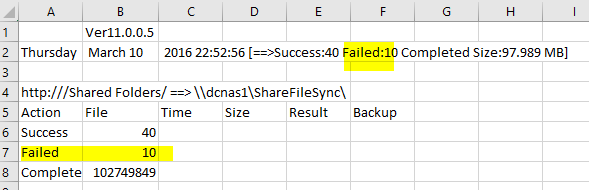

I have tasks setup to "Only export and/or send the log data of the failed items". My jobs are setup to backup deleted items to a network path using the Mirror option. I often get emails stating that there were failed items on the backup, but no info in the attached CSV file explaining what failed: [attachment=1]attachment 1.png[/attachment]

So really this is a twofold issue:
1. Why are the reports showing as having failed items but not displaying the file(s) that failed to backup?
2. Why are the file(s) failing to backup? I do see the file structure being created in the backup location, but indeed the file(s) that show on the backup logs as failed to backup are missing from the backup location. What I have found is that this most often occurs when files are NOT actually deleted, but rather they are MOVED, so they are being incorrectly identified as deleted vs. moved files (I do have the "detect moved files, move these files in the other side correspondingly" option checked. I also have the sync jobs running once per day vs. the real time setting.

Re: Failed items not showing on email log
Because the task runs in realtime mode, the synchronization result is the summary during the synchronization. It may fail to copy some files, but it may synchronize these files successfully later; So the failed count is no zero, but the log file may not contain failed items.

These tasks are not running in Real-Time sync. They are set to run once a day on a schedule.
