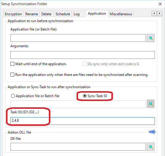

You can use the "Application"/"Application or Sync-Task to run after synchronization" to run task one-by-one after a main task:
[attachment=0]AppID.png[/attachment]
Application TaskID
Application TaskID
