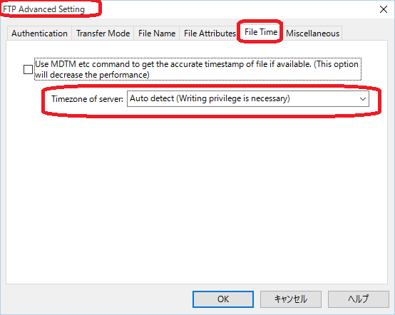

If your account of the FTP server has the write right on the FTP folder, then BestSync can detected the timezone of the FTP server, then set the time of downloaded file correctly; otherwise you need to set the timezone of the server manually by the following "Advanced" setting of the FTP folder:
[attachment=0]timezone.png[/attachment]
