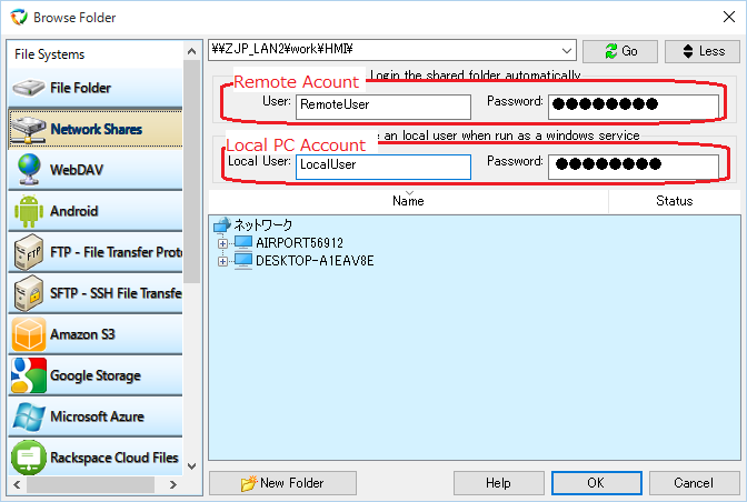

Re: Sync only one way automatically (NAS <--- Desktop)
If the synchronization does not work with NAS, please check if you have setup the login accounts correctly in the folder browser of NAS.
[attachment=0]SyncNetSvc2.png[/attachment]

Setup of the Login accounts is ok. Even when I use the PUBLIC Folders of the NAS, I have to manually start the task every time to force a sync. from the NAS to the Desktop. The other way around there are no issues at all (form the desktop to the NAS). It starts syncing automatically, when a change occurs.
Is it maybe a protocol of some kind on the NAS that has to be active...?
