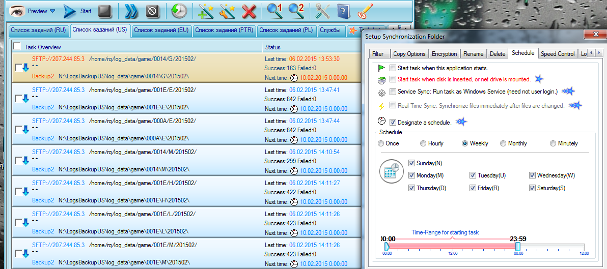

Sometimes BestSync can not start tasks. Screenshot is attached. Last sync was Feb 6, next sync was scheduled for Feb 10 (Friday-Monday my backup PC was turned off). However, all tasks are still stopped.
All tasks have the same sync properties, see screenshot.
What is wrong with schedule options? Business License is active.
Thanks in advance.
P.S. The registration page has wrong answer :) . Lasest version is 10.0.1.4. The right answer is 10.0.1.2.
[attachment=0]schedule.png[/attachment]
Re: Daily schedule
If you do not tick the check-box at the left of the task setting, the task will not started automatically by the scheduler.
