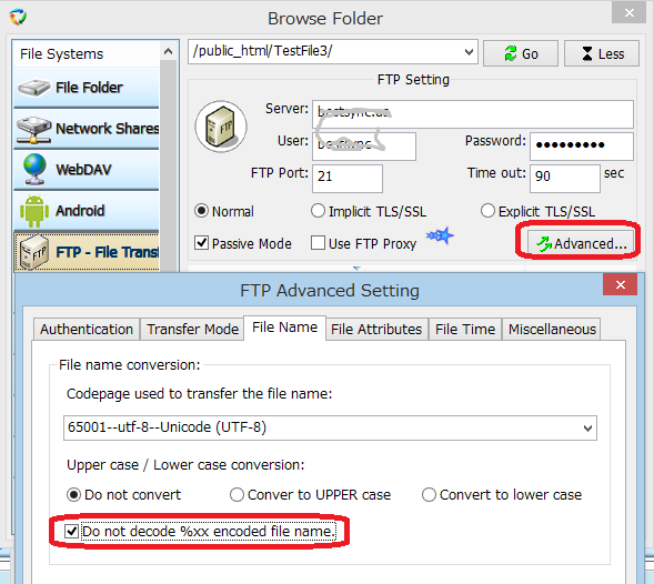

Please try to check the following option to avoid the problem:
[attachment=0]FTP-Decode.png[/attachment]
FTP no decode
FTP no decode

Thanks!!!!
