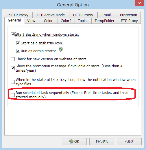

Re: Bug: BestSync 2014 job stopped sync under the running ta
Have you confirmed that the following option (Option/Option menu) is NOT checked?
[attachment=0]RunSeq.png[/attachment]
Run Task sequentially

The mentioned option is checked at the moment. Do I need it NOT checked?
If you want the tasks run immediately after being started, please uncheck the "sequential" option.
