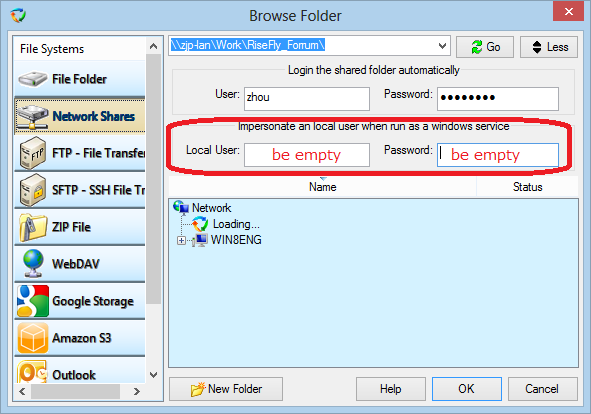

1. Leave impersonate account be empty.
[attachment=1]no_impersonate.png[/attachment]

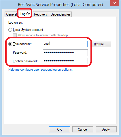

2. Setup a login account in "BestSync Service" of the "Service Manager" of the Control Panel.
[attachment=0]service_logon.png[/attachment]
- Leave impersonate account be empty
- no_impersonate.png (41.94 KiB) Viewed 14702 times
- Service Logon
- service_logon.png (14.41 KiB) Viewed 14702 times
