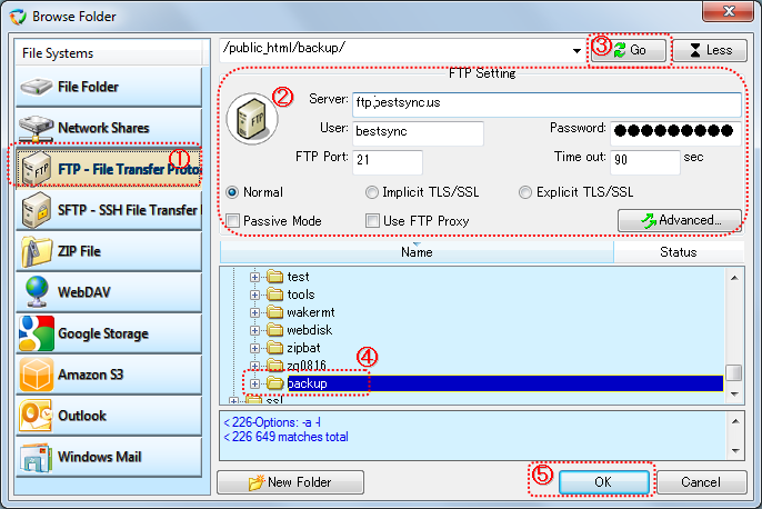

(1). Select "FTP - File Transfer Protocol" in the "File System" list.
(2). Setup the parameters for connecting to the FTP server.
Server:
The hostname of the FTP server, like "ftp.server.com". Or the IP address, like "192.168.10.1".
User and Password:
Set the user and password of the FTP account.
If anonymous logon is allowed, set “anonymous” in the User edit box, and your email address in the Password edit box.
FTP Port:
The TCP/IP port of the FTP command channel, usually it is 21.
NOTE:Please add this port to the allowed list of the Windows Firewall and Anti-virus software, otherwise the port may be blocked.

"Advanced":
(3). After set up the FTP host name and account, press "Go" button to connect to the FTP server, and list the folders in the FTP server to the tree view.
The log window below the treeview logs all the commands sent to the FTP server, and responses from the FTP server. If the connection between BestSync and FTP server can not be established successfully, please check the log.
(4). Select the folder in the tree view.
(5). Click "OK" button to end the dialog box
