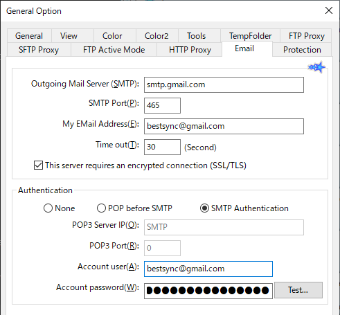

Hint: Set a Gmail account as the outgoing mail account:
Outgoing Mail Server (SMTP)== smtp.gmail.com
SMTP port==465
My Email Address==The mail address of Gmail, like "bestsync@gmail.com"
Timeout--60
This server requires an encrypted connect (SSL/TLS)--Tick the check box.
Authentication==SMTP Authentication
Account user==The mail address of Gmail, like "bestsync@gmail.com"
Account password==Set the 16 characters " App Password "
Please do not set the password of your Gmail account, otherwise the authentication will fail with the following error in the response.
534-5.7.9 Application-specific password required. Learn more at
534 5.7.9 https://support.google.com/mail/?p=InvalidSecondFactor iw20-20020a170903045400b0015e8d4eb2adsm951843plb.247 - gsmtpFor how to generate the "App Password", please refer to "Create & use App Passwords" part of the following URL:
https://support.google.com/accounts/answer/185833?visit_id=637905328868491009-360576437&p=InvalidSecondFactor&rd=1&hl=enNOTE:Please switch on "Allow less security apps" to "ON" in your Google account, otherwise Google will block apps that use SMTP etc legacy protocol like BestSync from sending email.
Here is the link to change the setting:
https://www.google.com/settings/security/lesssecureapps
