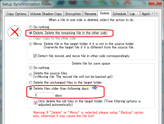

1. Files older that 3 days will be deleted.

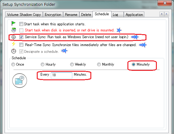

If a file is deleted, it will be deleted from AmazonS3 less than 10 minutes.
[attachment=0]WzScheduleMinute.png[/attachment]
2. If you need the task run in background in the server, please select “Service Sync” in “Schedule” TAB.
[attachment=1]WzDelete3Days.png[/attachment]

Wizard Delete Old Files
Run As Service
Run As Service

We have confirmed that there is problem when synchronize with AmazonS3 as Windows Service.
At the current stage, please uncheck the "Service Sync: Run Task as Windows Service option" to avoid the problem.
