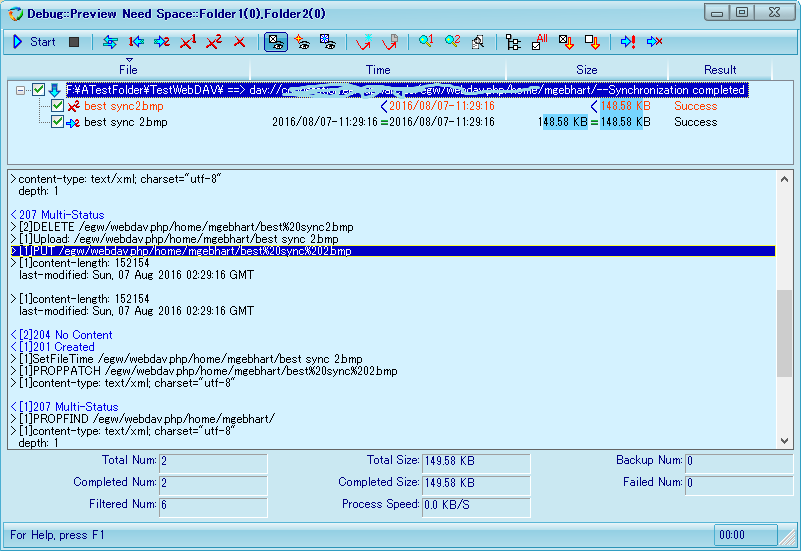

BestSync encodes space to %20 correctly, you can start the preview of the task to confirm it.
[attachment=0]test.png[/attachment]
SpaceEnocde
SpaceEnocde
