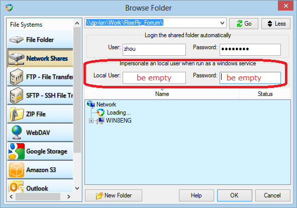

My last remaining issue is that I cannot connect to the mapped network drive or shared folder. I have tried using the appropriate credentials in the browse dialogue or using the mapped network drive when that had been authenticated with the admin credentials. The browse dialogue lets me browse to the folders successfully, however every time the copy initiates I get the "Drive Not Ready" error.
Any help you could please provide would be greatly appreciated.
Re: Amazon S3 Connection Issues?
Is the task set to run as Windows Service?
[attachment=1]no_impersonate.png[/attachment]

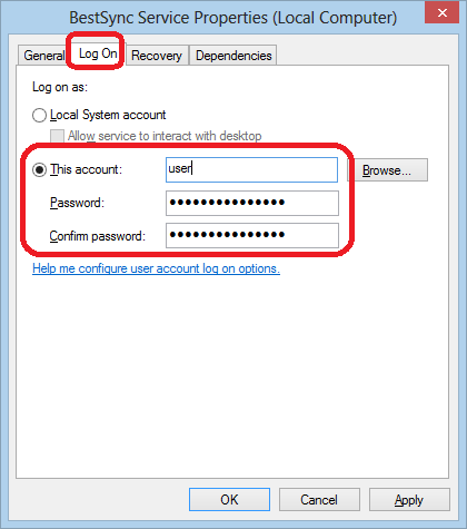

If the task is set to run as Windows service, please setup a local account in BestSync Service in the Service manager of the control panel.
[attachment=0]service_logon.png[/attachment]
