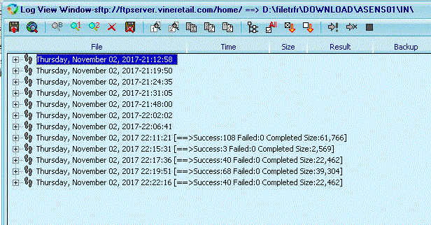

keep on resynching file
Re: keep on resynching file
attached is the bestsync log screen shot
the source files get transferred again after I move them to another files.

- bestsynclog.GIF (47.59 KiB) Viewed 25377 times

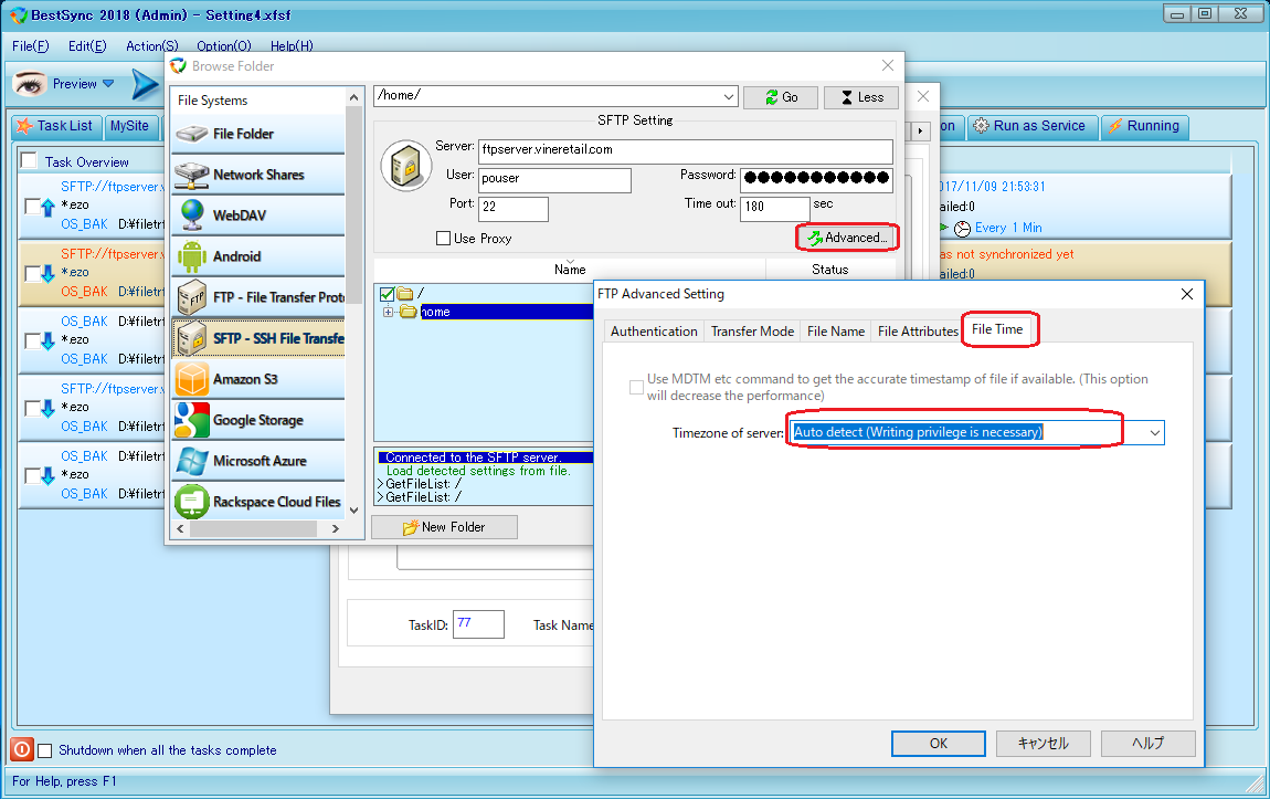

I noticed that when I used my pc windows10, bestsync download the file and the timestamp got change or converted same as with my pc time and bestsync work normally as it does not copy previous files that have been download.
but in my prod server windows 2003 , bestsync download the file and the timestamp is same as with source folder (ftp server) and bestsync keeps on resynching the files unless the files get deleted from the source .

I really do not know what happened in your systems, if it is possible, please export the tasks in Windows PC and server to files, then send the files to risefly@risefly.com, so we can debug this issue.

Thank you for the exported task settings.
I have tested the synchronization of the tasks, all work fine on my PC.
I do not know what happens on your server, it seems that BestSync was unable to detect the timezone of the server (May be it failed to write file to the server or the written file was moved during BestSync detecting the timestamp of the written file). You can avoid the problem by setting the timestamp of the server explicitly like the attached screenshot:
[attachment=0]FTP_TimeZone.png[/attachment]
- Set FTP timezone
- FTP_TimeZone.png (134.29 KiB) Viewed 25343 times
