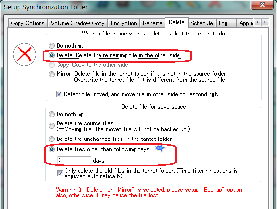

1. Files older that 3 days will be deleted.
If a file is deleted, it will be deleted from AmazonS3 less than 10 minutes.

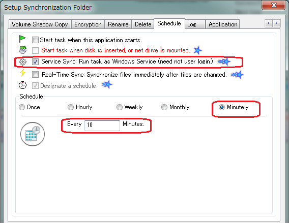

[attachment=0]WzScheduleMinute.png[/attachment]
2. If you need the task run in background in the server, please select “Service Sync” in “Schedule” TAB.
[attachment=1]WzDelete3Days.png[/attachment]

Wizard Delete Old Files
Run As Service

Postby RiseFly » Wed Jun 27, 2012 2:37 pm
We have confirmed that there is problem when synchronize with AmazonS3 as Windows Service.
At the current stage, please uncheck the "Service Sync: Run Task as Windows Service option" to avoid the problem.
