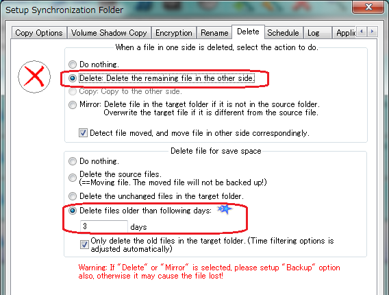

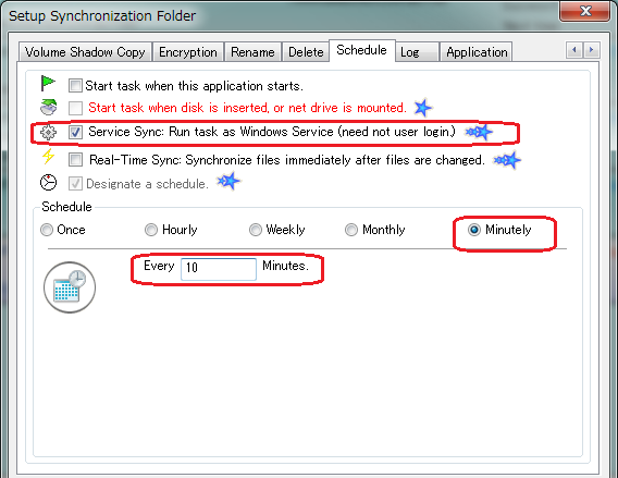

BestSync can do exactly what you want.
You can set the options like the following:
1. Files older that 3 days will be deleted.
If a file is deleted, it will be deleted from AmazonS3 less than 10 minutes.
[attachment=0]WzScheduleMinute.png[/attachment]
2. If you need the task run in background in the server, please select “Service Sync” in “Schedule” TAB.
[attachment=1]WzDelete3Days.png[/attachment]
3. You need the Ultimate License to synchronize with Amazon S3.
- Wizard Delete Old Files

- Run As Service
- WzScheduleMinute.png (42.57 KiB) Viewed 10382 times
Re: interested in buying BestSync
This software is buggy or something. I did exactly what you said. Nothing is synchronizing
We have confirmed that there is problem when synchronize with AmazonS3 as Windows Service.
At the current stage, please uncheck the "Service Sync: Run Task as Windows Service option" to avoid the problem.
